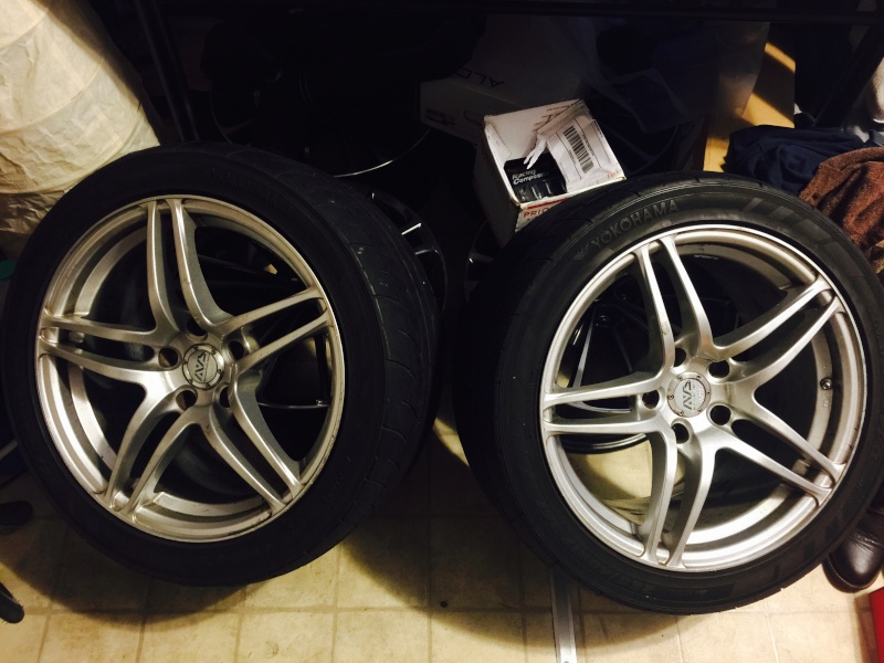

I didn't want to fuck around anymore and so when I heard Albert "Wavybert" got a hold of 17x9 AVS 5 I wanted them.

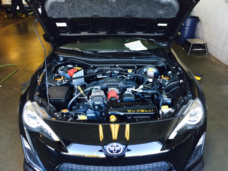

My buddy Kace sold his TRD intake for a really good deal so I couldn't pass it up. I figured I'd need it for the power mod I was getting soon.

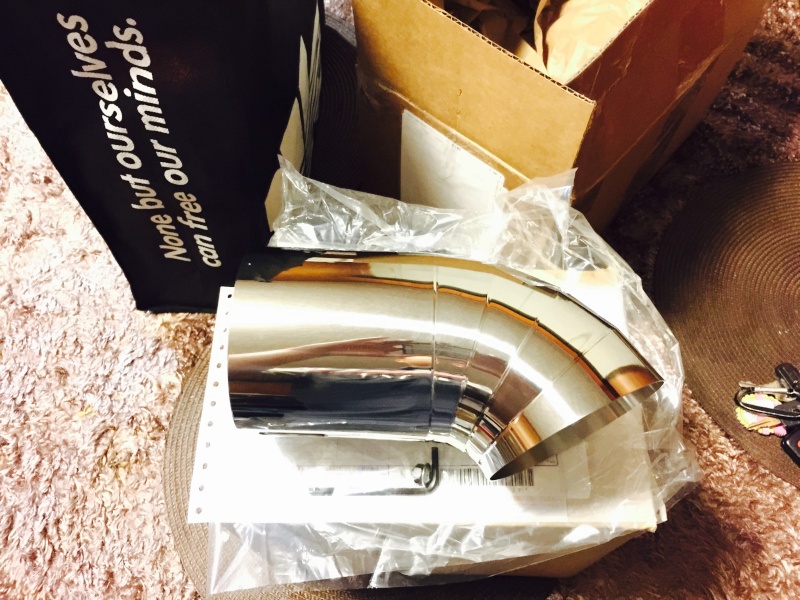

On another note my URAS tip came in the mail! Just the tip though lelel.

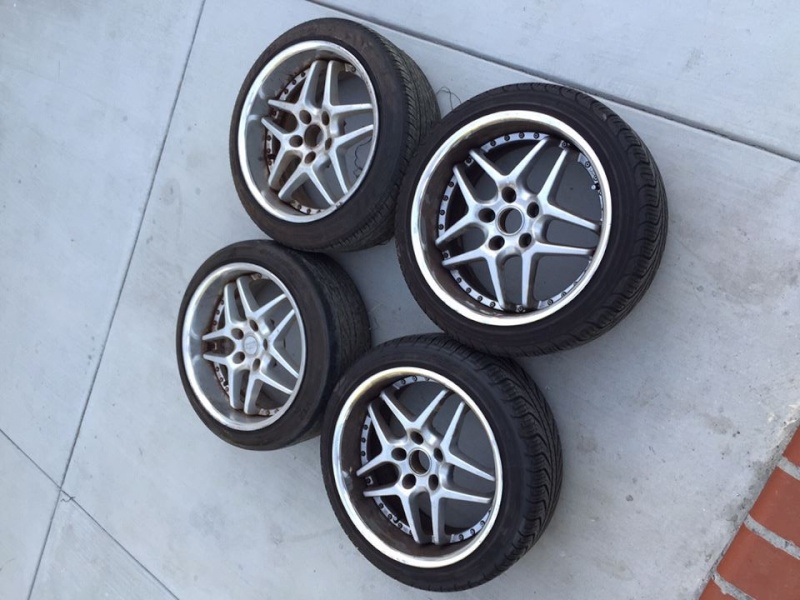

More wheels

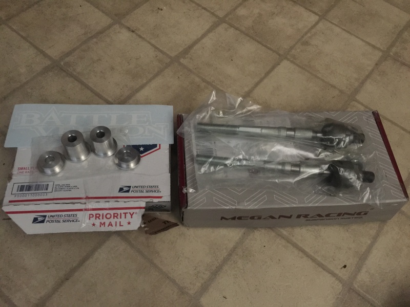

I picked up some things for better angle and a more solid feel in steering. I know Megans are lame but these were the only inners available that had built in spacer to gain better angle.
The accidental purchase of a FUCKBOYR-S Megan10

Solid Battle Version rack bushings over marshmallow bushings for better feedback.
The accidental purchase of a FUCKBOYR-S Bv10

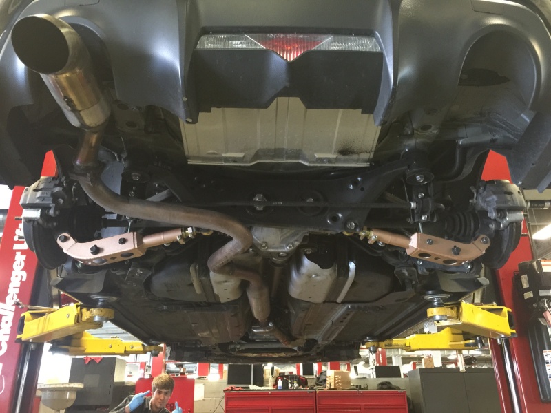

I couldn't run the blitz in the rear because I ran a lot less camber in the rear and with the 5x114 spacers it just wasn't happening.
The accidental purchase of a FUCKBOYR-S Frs610
Perks of working at a nice shop with an in-ground alignment rack (wish I still worked there).

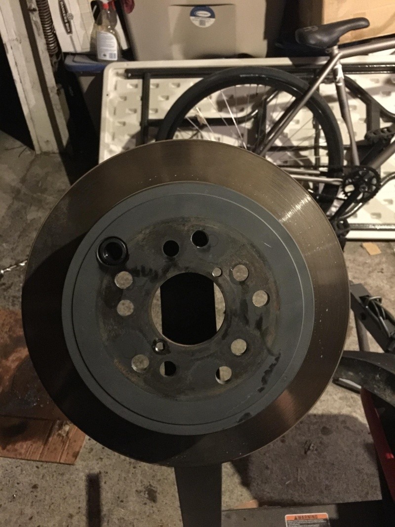

A few weeks later my STI rear hubs finally came and I could not wait to install it. 06+ STI rear hubs are 5x114 and is a direct bolt-on to the frs uprights. Only problem is having to drill 114 into my existing rotors and shaving down the bore from 55.1 to 55.6. Very minimal indeed but it would not fit unless bored down.
